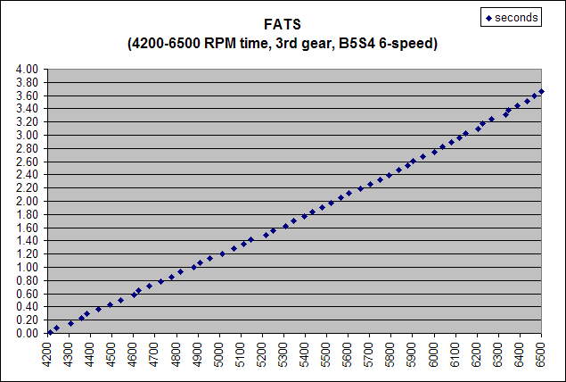

FATS: |
3.66 |
<-- Time in Seconds from
4200-6500 |
